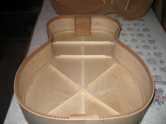

Hesh ....your back looks great.....another git I'm looking forward to seeing..
I will post some progress pics once its all glued up.....

We've just changed to this style of bracing on OM's after a discussion I had with Colin Symonds and Dave White.
The X braces certainly hold the radius of the back better.
We're just about to string up 2 OM's that have ladder bracing (all tall and thin), so I can't really comment on tonal differences until they're all built.
(trying to compare a Rock Maple guitar with an EIR one will probably be like comparing apples and oranges anyway )
I think what you are doing will be fine.
